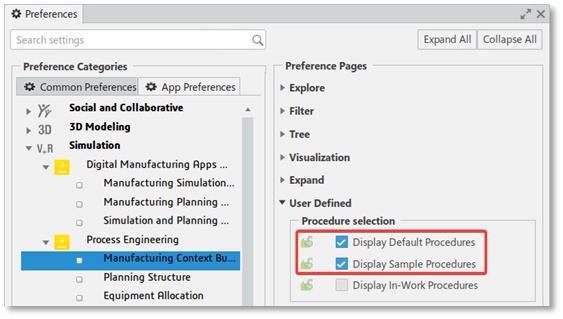

OOTB provides a list of default and sample procedures, that are already available to the user through user preferences.

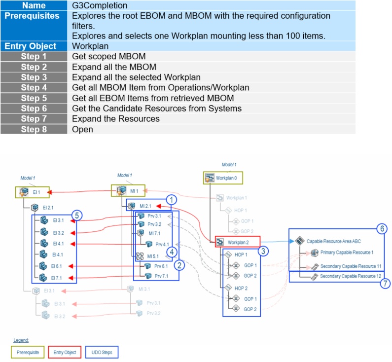

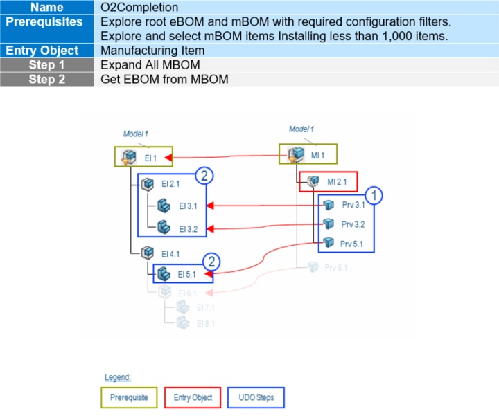

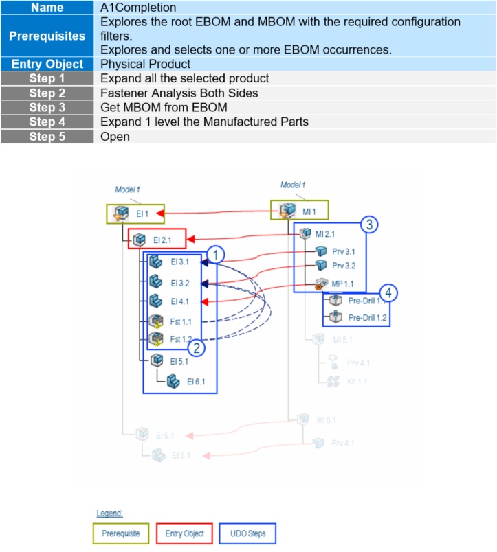

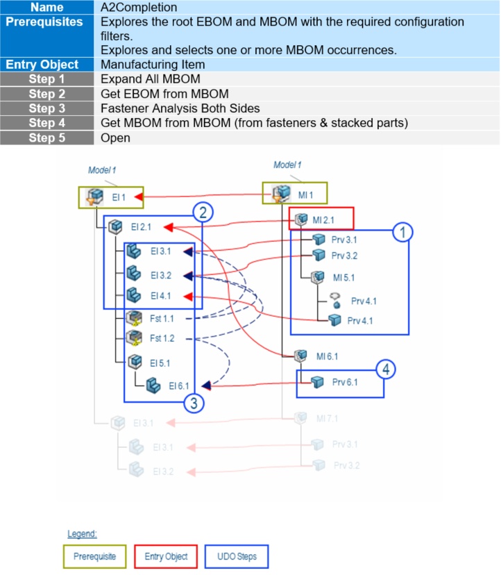

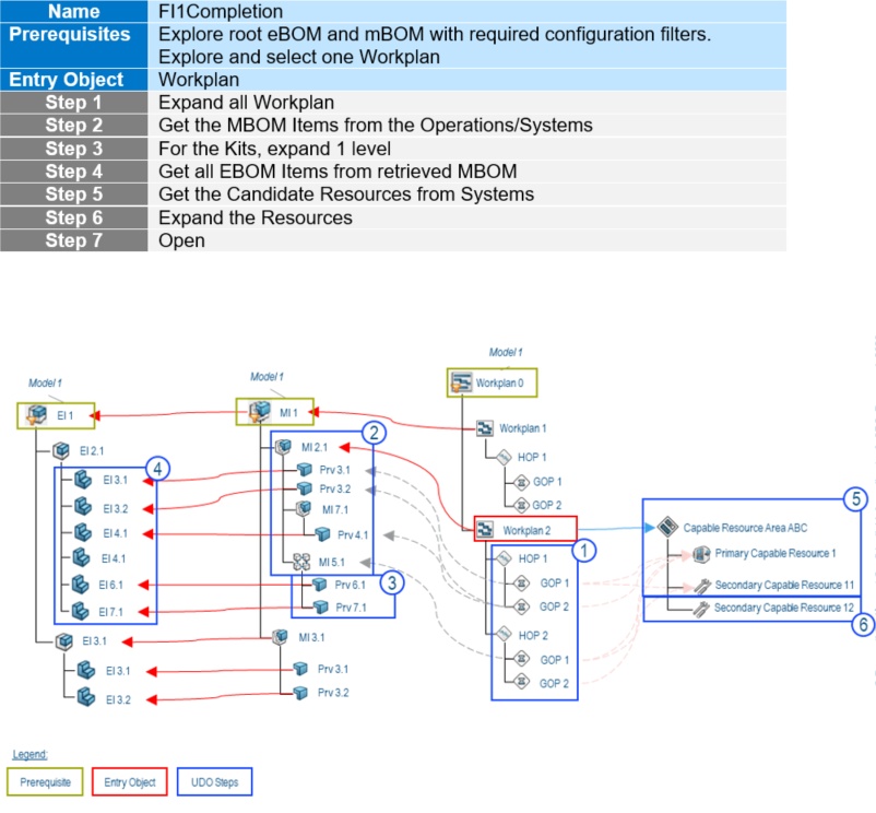

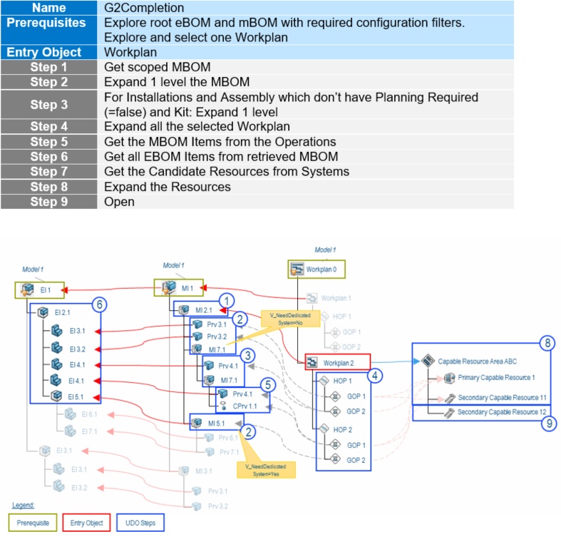

This chapter will explain in a functional and simplified way what are the steps executed by each Default Procedures.

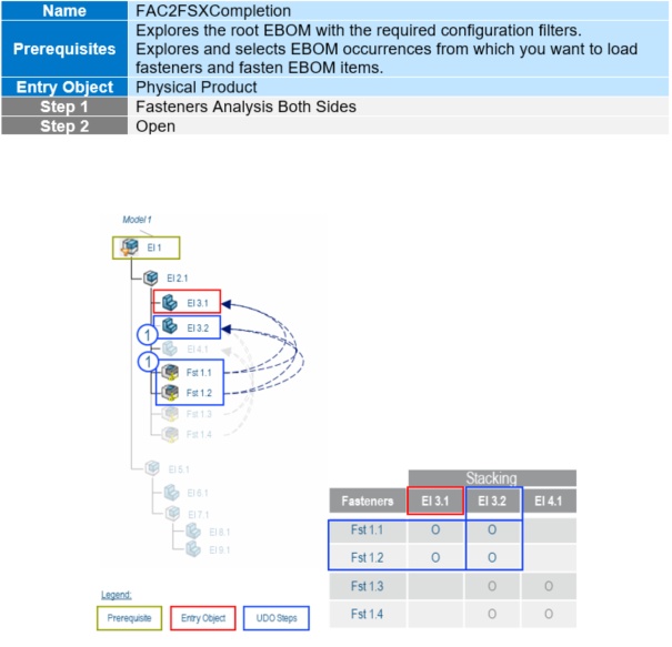

[F1] FASTENER: Load Fasteners and Fasten EBOM Items from EBOM Items​​​​​​​

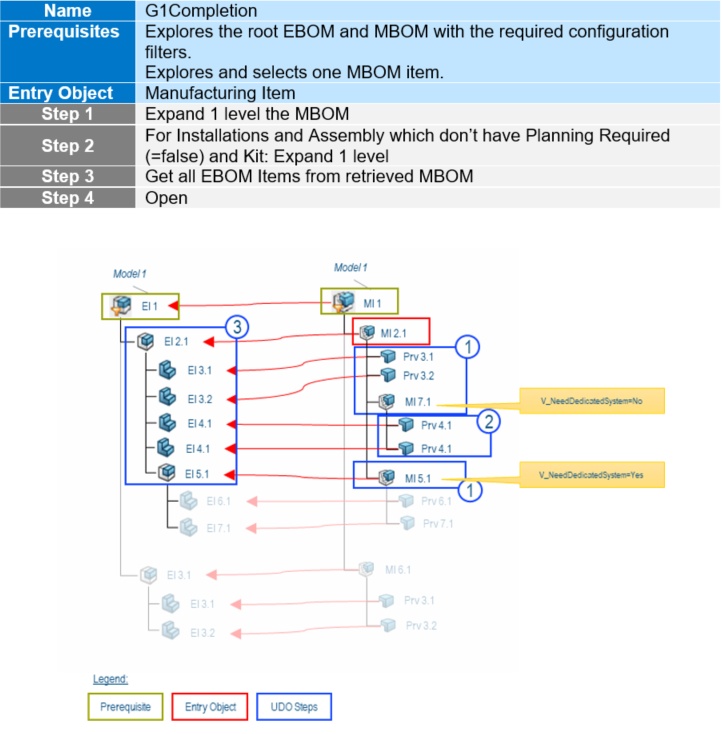

[I1] ITEM: Create/Update MBOM Items from Their EBOM Definition
[I2] ITEM: Create/Update MBOM Items from Their MBOM Definition

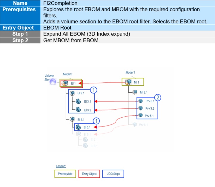

[I3] ITEM: Load MBOM Items from Volume Filter
[I4] ITEM: Load Small Assembly or Install
[I5] ITEM: Load mBOM Items installed by the selected Install and before but closer than 500mm

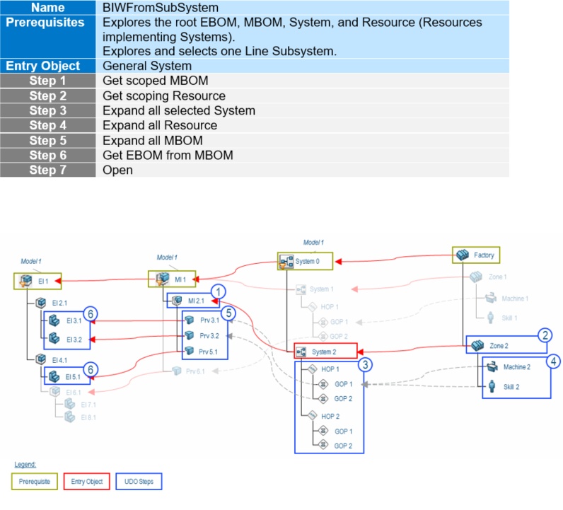

[S1] SYSTEM: Load Resources and MBOM Items Operated by a Line Subsystem
[W1] WORKPLAN: Create a Workplan to Produce an MBOM Item
[W2] WORKPLAN: Edit a Workplan to Assign MBOM Items to Operations
[W3] WORKPLAN: Edit a Workplan to Add or Update Its Work Instructions and Resources
[W4] WORKPLAN: Edit a Workplan Producing a Small Assembly or Install
[W5] WORKPLAN: Load MBOM Installed by the Selected Workplan and Predecessor but Closer Than 500 mm and All Associated Resources

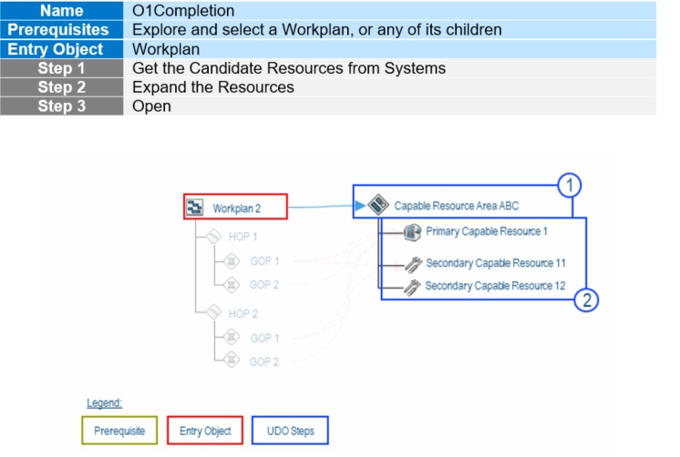

[R1] RESOURCES: Retrieve Resources Linked to the Selected Workplan Entities
